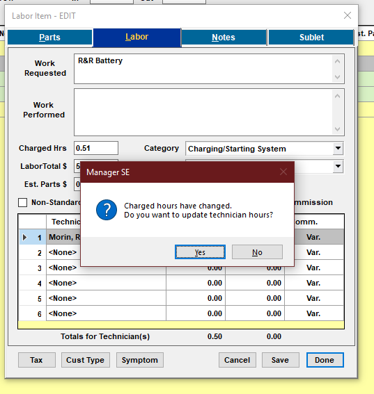

We're trying to use this but we're running into some issues. Let's say we have a labor line that is .5 charge hours, .5 tech payed hours, and the tech punched in and had .25 in it.
1) The writer decides to charge the customer .7 hours instead of .5.....when he changes it mitchel changes the actual time to the .7. This makes the act of punching the clock absolutely useless.
2) Even though the tech punches in and out on the tablet. He can manually change the amount of time it shows. This should be password protected so the tech can't change it.

nessauto wrote:We're trying to use this but we're running into some issues. Let's say we have a labor line that is .5 charge hours, .5 tech payed hours, and the tech punched in and had .25 in it.
1) True, but you HAVE a choice. Just say no to the dialog and the tech punches will remain.
2) Agreed
