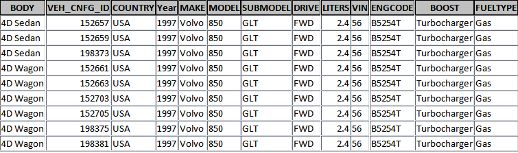

This car has a 2.4liter 2.4 turbo Engine code 56, mitchell decodes it to be a non turbo VIN 55, which is incorrect. In fact Mitchell does not even show an option for a 2.4 turbo, VIN 56 for any option. It only shows 2.4 non turbo VIN 55, or 2.3 VIN 53 (high pressure turbo) This causes a problem with some integrated catalogs where turbo and non turbo parts are different.

This has now been corrected and will appear in ProDemand very soon; it will appear on a Manager SE 6.5 update ASAP (when I get date info I will post).
