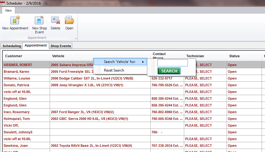

Bill Coniam wrote: The ability to choose (like Regular, etc) “list view” (like the old scheduler) that would give us some what we lost.
The Appointment Tab in the scheduler:

While the appointment tab has its own use, it does not take the place or provide the same information as the previous schedule. The appointment tab only shows job hours. Job hours is not easily changed, mine always shows 0 which is not helpful. Then you have order hours and scheduled hours. I think it is excessive.
If I had the option to go back to the original schedule I would do it in a second. All the new features are great, but until the new schedule at least does the few things that the old one did I am not going to be satisfied I am sorry.
You added a bunch of bells and whistles to the car but removed the drivetrain in my opinion.
The new schedule is like a calculator. There are basic calculators and scientific models. Maybe we can have a choice of which one we want. I am fine with the basic calculator, I am not trying to find out the specific gravity of my customer. I am on version 7.0.3 as a note.

Thanks for the reminder of the search function, but the "search" you posted while great to find a name or a car, it shows all appointments, it will not, even sorting by date, show me my workload at a glance. And the "status" column isn't much help if they are all going to say simply OPEN or CLOSED, whether the car is here yet or not.
I agree with your comments below your screen shot.
