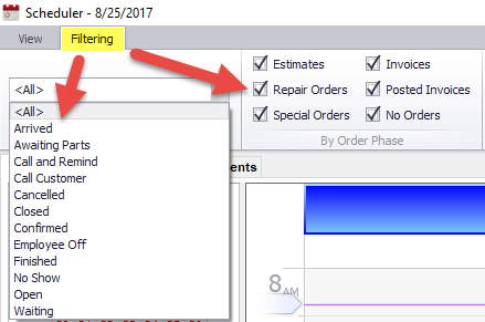

Welcome to the forum and thanks for posting. This is the first report I've seen; I might suggest a review of display settings and to check if any Filtering may be in effect.

Everything is checked under filtering and resource view mode.
