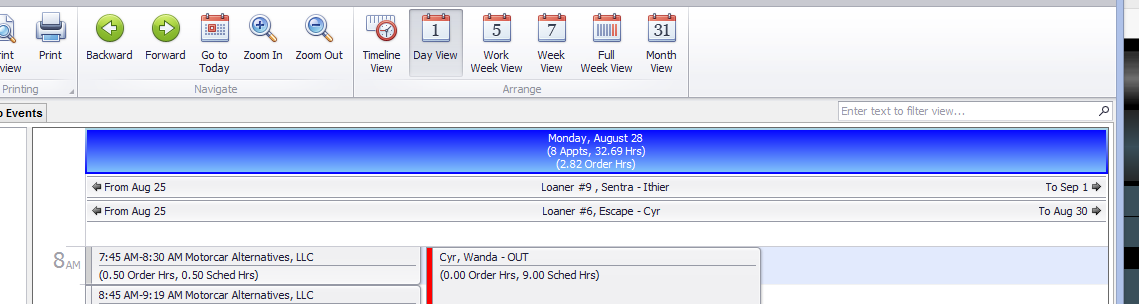

We track all 5 of our loaners on the new scheduler. Each loaner is a 'customer'. Each loaner gets an 'all day' status; that puts it on the top of the schedule and out of the way of real work. We then modify the subject line to include the customer taking the car. We can easily expand or contract the duration with the scheduler at any time. Openings and conflicts are easily spotted.
example of using the scheduler to track loaner cars
I'm sure there are dozens of ways to do this. Here is just one example. Maybe enough to get your own take on adapting it to fit your shop.
