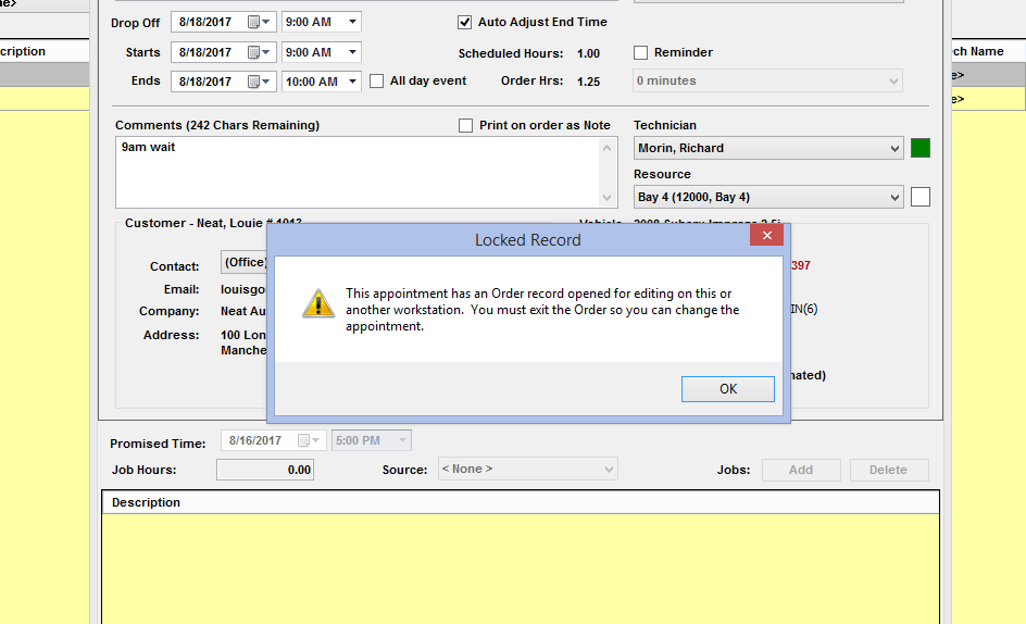

LOL. I no sooner post this and then it happens again. Here is a screen shot and the steps taken.
locked record
locked record
I started a new Estimate. Entered all the needed labor lines and clicked on Options>Appointment. I filled out the appointment window including the technician and resource fields and when clicking on Save and Close I got this message.
Fortunately I could click away without closing the appointment editor window or losing my information. Once I closed the order, I could continue.
