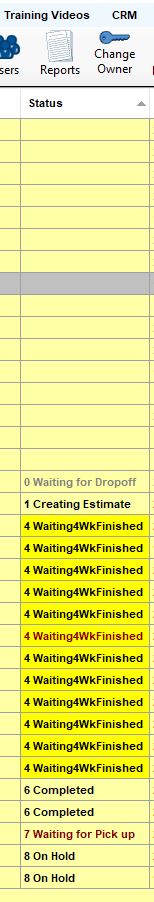

I've been using the SEARCH feature in the WIP screen to prioritize my Statuses. VERY helpful when dealing with whats here for work, waiting for parts/ test drive etc. If i were able to sort alphabetically by customer as well as status, would be extremely helpful. In other words, allow both columns to sort at same time like scheduler...

You can. Click on the Status column to sort either ascending or descending. Then hold the CTRL key on the keyboard and click the Customer column. That should give you a secondary sort.
Hope it helps.

IT WORKS, Thanks!
