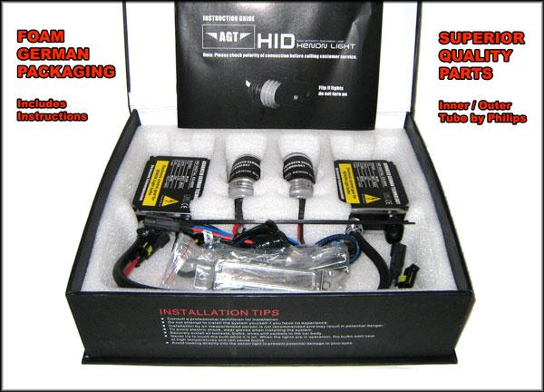

check the head light bulbs themselves, is there a bo-bo kit like this in there?
cav hid.JPG (44.96 KiB) Viewed 4034 times

It does have some Hella Blue bulbs in it, and it did do this before that. The cust. bought the car this way, as the person selling it told them it was a bulb. They had it at 2 different shops, and they both looked at it and said take it to someone who specializes in electrical, they couldn't figure it out. That is another reason I want to figure it out, to be the hero, after all we all like that. I just found something I didn't see before, is that when the indicator says bright the lights are actually on dim and vice versa. May be the key here??? Going to look further. It only blows the left fuse, thats what is funny, and only when it is running so it is when the drl turn on.
