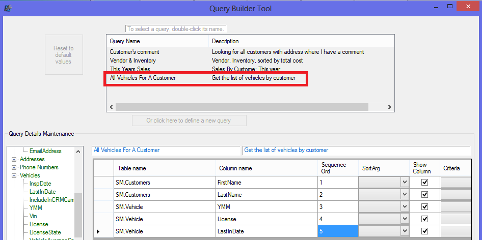

I hate to be the one to continue to post things like this; however this report is ready in Report Pro (SE Version) with the Query Builder Tool.
First Click on this Button:
Report Pro Query Builder Button
Then quickly choose the fields you are interested in:
Report Pro Query - All Customers Vehicles
We built this tool based on requests just like this one, why wait for a report to be pushed out, make you own!
