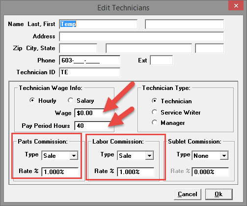

OK. Let's review.
You should have all your techs inputted under Tech Setup. You should have values for the arrows or the boxes as shown below.

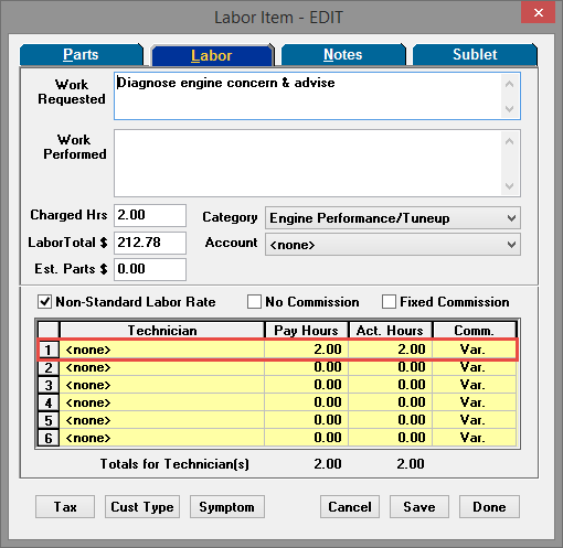

When finishing an order, make sure to input their name and time as shown below.

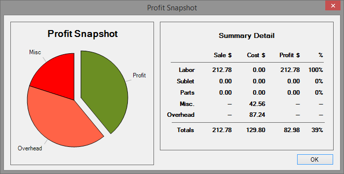

Here is a profit graph of the above labor as shown without any tech inputted.

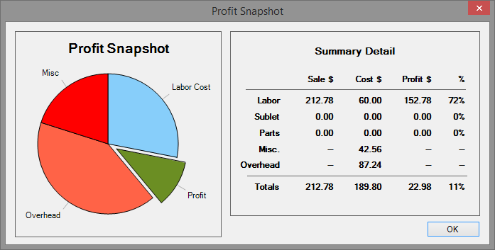

And here is the same order with the tech added. Notice we now have a value in the Labor Cost field and the profit has changed.

The profit report is driven by the 'Pay Hours' field. It does work properly. If you do not change the 'Pay Hours' field, your profit graph will not change.
How you enter this data will depend on how you pay the tech. If he is hourly, then enter the actual time in both fields. This will give you a true representation of your profit. If your tech is flat rate, then enter the pay hours and actual hours as assigned.
