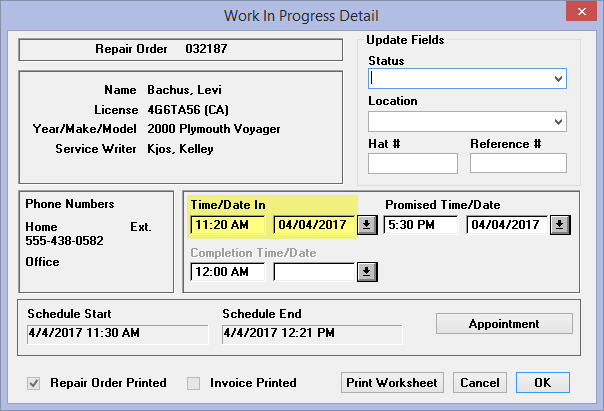

If I understand correctly, I believe you are referring to the Time/Date In as "timestamp"? Nothing has changed in the software in this regard and I just had the field fill in automatically:

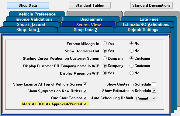

The trigger is marking the R.O. as PRINTED; this is either accomplished by steps manually or automatically if you have the Mark All ROs as Approved/Printed option box checked. You might check your settings.

Perhaps we're getting hung up on semantics; Printed/Approved is a SINGLE event. There is no actual 'Approved' phase in the software.
