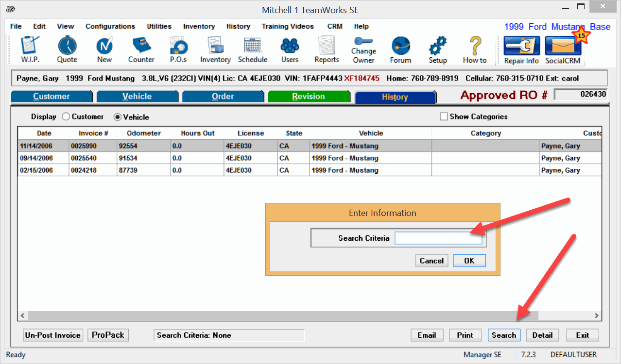

Welcome to the forum and thanks for your post. You don't have to examine ROs one at a time; you can look at history from both a general (F4 Find History) or vehicle specific (History tab) sense.

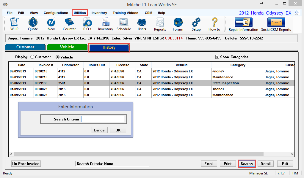

The History tab is handy in the current repair order (5 tab view) to see what category, mileage, etc. for each past invoice with a Search that reads parts and labor descriptions to narrow the list to what you're looking for. This History tan is also available in a 3 tab file maintenance view - Utilities menu and then select either Customer screen (by name) or Vehicle screen (license plate, VIN, etc.) to select the record and go to History.

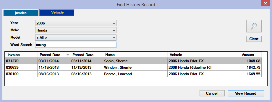

Utilities - Find History (F4 key) allows you to see history in terms of Invoice #s or Vehicles; the beauty of this screen is that you can do a fuzzy search (partial YMM - 2006 Honda, Ford Mustang, etc. along with word search term like axle, radiator, TPMS. timing, etc.) and see ALL past work that matches your search criteria.

Open the customer vehicle screen, click on the HISTORY tab. Once in the history tab for that vehicle, click on the search button, enter 'control'

I make sure everything is categorized. Make sure the box is checked to show categories under history then just scroll down to what item you are looking for. Brakes, tires, oil change, etc.
