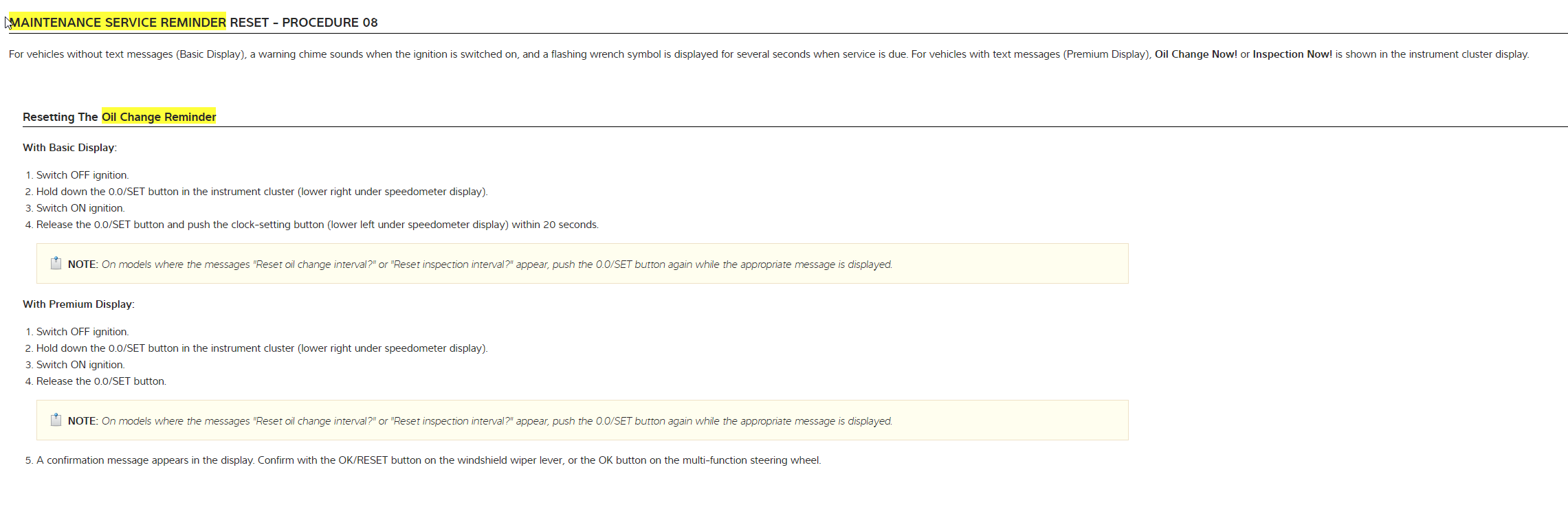

This information is in the product, but not immediately showing under the Reset Procedures. Tim will likely have to check that with our editorial department. I'm sure you have it by now, but if not, here it is from ProDemand:
2020-04-08 11_29_51-ProDemand Automotive Repair Information - Mitchell1, Snap-on Inc..png
2020-04-08 11_29_51-ProDemand Automotive Repair Information - Mitchell1, Snap-on Inc..png (78.47 KiB) Viewed 6085 times
