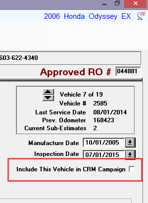

That's odd. I'm not aware of this being an option. Are you using CRM? Perhaps this is only activated when you have the CRM upload utility. One thing to note that I have found is that this only works for CRM reminders, which I may have inaccurately assumed you meant. For followup letters that YOU do internally, this button has no effect. If you are using CRM, this can be found on the vehicle tab..........
Once on that tab, you should see it here.......

Compared two SE 6.5 rigs; one has the checkbox on the Vehicle screen and the other doesn't. The one that does is a company laptop new last year that I thought never had anything CRM installed. So the Opt Out checkbox only appears when a certain DLL file is present in your system. Manager SE looks for these when it starts up and dynamically "grows" the appropriate options to be visible as is the case here.

The checkbox I am referring to is the one you don't have; the box on the vehicle screen. THAT box does not affect in-house reports. I just tested it again on my system to be sure there had been no changes since 2004. So IF you had that box and IF you unchecked it, that vehicle will still show up in the list. It's designed to work with CRM, not in-house reporting.

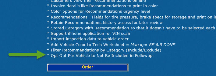

It's already there......
opt out
opt out
