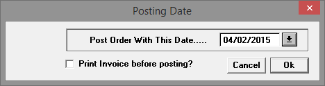

Here's a workaround for you from my Service Advisor.
When you are creating Invoices, do not print them right away. Post each Invoice first to the date the work was done
change this date to the date the work was done

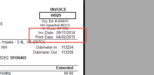

Then go into History for the customer and print the Invoice from History. This will show two dates, the Work Performed date and the Printed date.
work performed date now matches
It's a few extra steps but gets you what you want.
