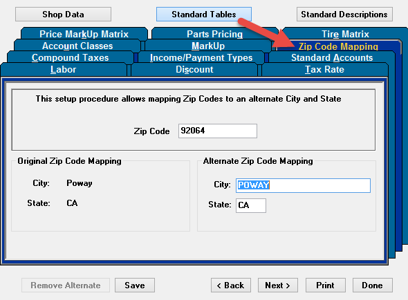

In the meantime, you might consider changing your most popular zip codes to be CAPS using the Zip Code Mapping option under Standard Tables:
